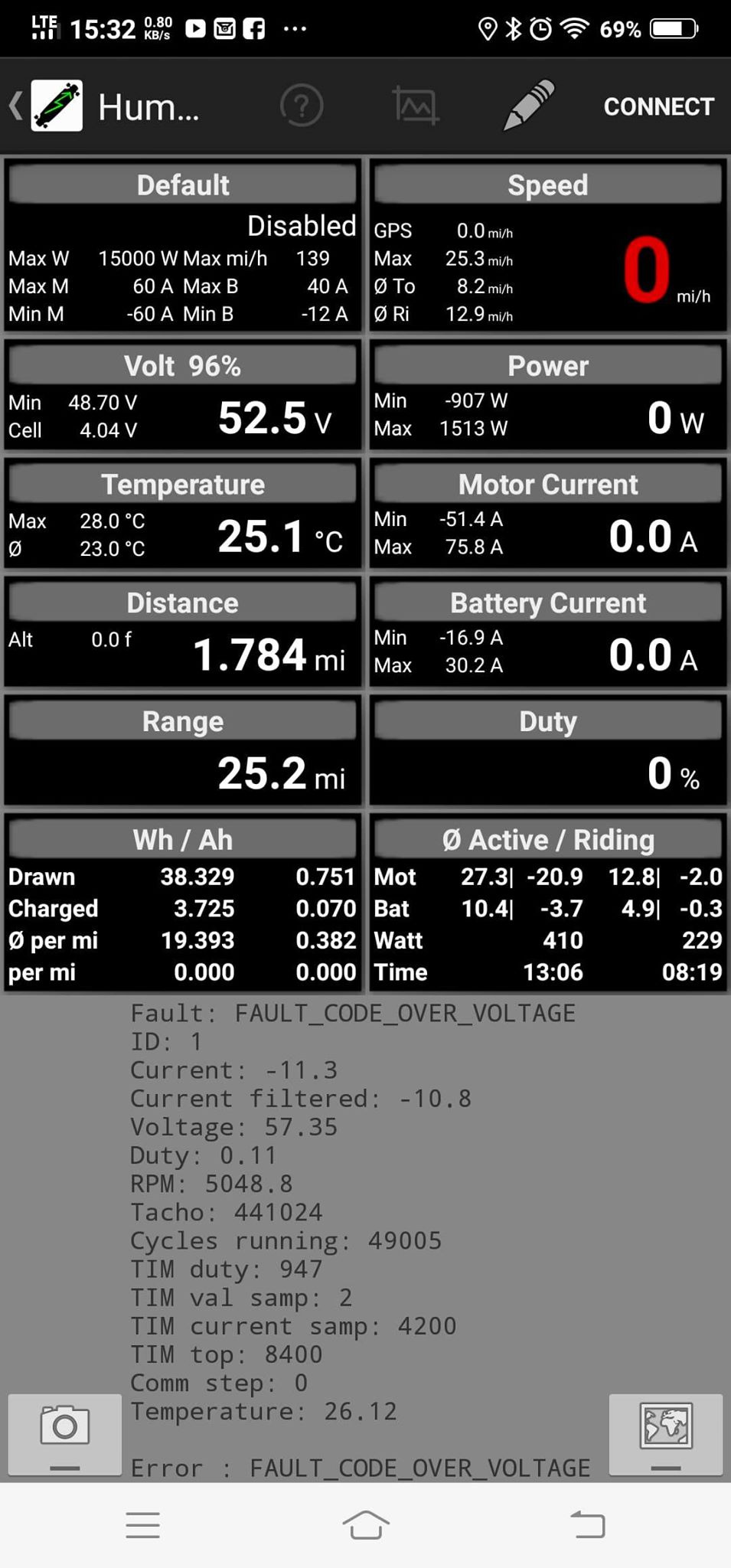

Hey guys having a problem when I have my battery freshly charged. With the known issue of the voltage reading fluctuations with the Flipsky 6.6 singles and duals has anyone else experienced braking loss basically no brakes due to an over-voltage error. This is happening to me on one of my builds but only when the battery is fresh. Once the battery has drained down some of its voltage or capacity the braking issue goes away. My question for you more experienced individuals is, is there a workaround for this issue?

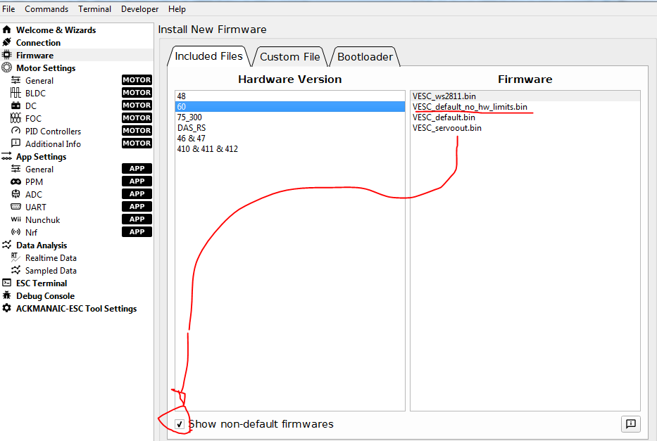

If you run the “no hardware limits” firmware you can turn up max voltage to 59v but that might be a bad idea if the vesc does not have accurate readings. Could result in more than 60v in use.

Max voltage is set at 57. Where do I confirm that no hardware limits setting? Can I find that using METR pro or do I need to crack open the enclosure and plug in via USB?

Its not a setting, its a version of the firmware that does not have software limits. Its a use at own risk type deal. You have to re-load the firmware to take advantage of it.

I do not suspect that it is a bad battery. It’s brand new build from Ernesto aka Kaly. 12s4p 20700b. This problem only occurs when the battery is fully charged. I can only be going 5-10-15 miles per hour it doesn’t matter the speed. I could have only traveled a matter of feet and the problem occurs. as for the length of the braking it the problem pops up a fraction of a second after I hit the brakes.
I am fully confident that the battery is not experiencing the perceived over voltage. I feel it has to do with the voltage fluctuation readings from the 6.6’s. Hopefully tomorrow morning I can get the 6.6’s out of the board and remove the antispark switch and hook up my unity and give it a go. We’re expecting rain for all if not most of the day tomorrow so it may be Saturday before I can get back with you guys to inform you if the 6.6’s are the cause. My gut tells me that, this may be the cause.

Cant get much shorter on the wire lengths. The length is less than 6 inches. Yeah I guess if the no limits hardware firmware doesn’t fix the issue I’ll build a cap bank but I really don’t think the voltage spikes are real rather poor design by flipsky. I can be sitting still and my Metr Pro will show my full battery bouncing between 95% and 100% with no input at all or load. The board and all items are sitting static and it bounces all over the place.
