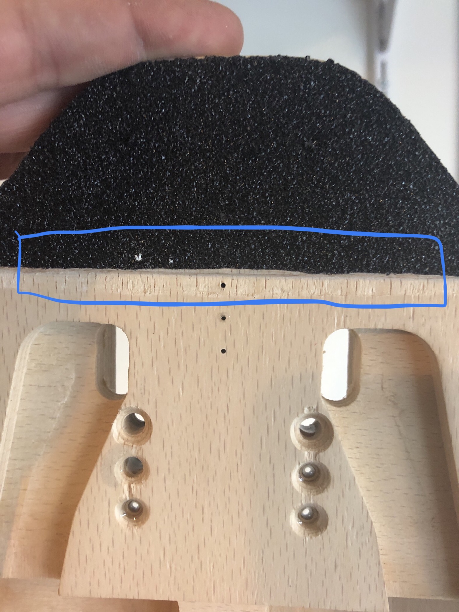

I have one suggestion to throw in the mix, have you considered just making the entire top layer the aluminum plate. I would assume this would be easier to make and wouldn’t require much fine tuning to get the lines to meet up nicely.
One more thing, add a bit more “gap” where the wood and the aluminium meet. I couldn’t get the cover to fit back on flat once i removed it (didnt notice if it was like this to begin with)
Had to file down less than a mm on each side of the wood to get the lid to sit properly.
The early prototypes where like that. The idea behind baking it a 3 piece system is enabling the openig of the lid without loosening the truck bolts. It would be easier to make, thats true…
My father glued the pieces a bit too tight, we wanted to make the gap as small as possible . The issue is that on some it was “too” small
to get the cover back, I just bent it a little bit and then it snaps well in place
No big deal, even if there was a small gap, it would act as a guide for a knife while grip tapping
