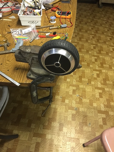

@longhairedboy I just was messing around and put a hoverboard wheel on the vice and used an old esc to power it. its brushless and sensored so it worked pretty well. I was using 22 volts and it spun at 7 mph haha pretty lame for a longboard but alot of torque. Cant even hold it.
Those motors though⌠theyâre huge and those stators could be re-wound pretty easily.
