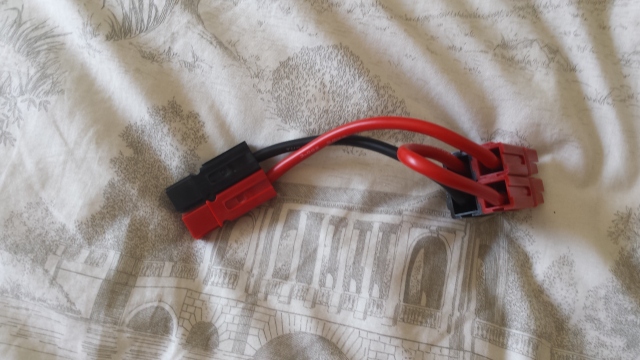

If you have 3+ bricks a harness becomes useful. You must add an extension from every connection from the lipo to an anderson powerpole connector, They can stick together in modules like this,
so you have all the connectors together, then you have to solder two cables one for the series like this add as many series connectors as needed you use that cable for discharge and you need to do another parallel for charge like this so you can change from series to parallel just swapping one section. this is a parallel balance cable for more than two bricks That´s the best way. It’s fast and safe. If you do bulk charge you just make an adaptor from a common charger to the series discharge cable you have. As i said earlier is very dangerous if you do not do it right. You must lower the voltage from 42v to at least 41 in order to leave a reasonable margin for disbalance issues. Or use a buck converter to set the voltage and amps you need. https://www.amazon.com/KNACRO-10-120V-charging-voltage-adjustable/dp/B01FGZ8HJE/ref=sr_1_1?s=electronics&ie=UTF8&qid=1501262232&sr=1-1&keywords=dc+converter+900w Do not bulk charge more than 5-10 times in a row. Balance must be done often. I recommend the bulk charge only for responsible people. Do it at your own risk. Or just use bms like other dudes recommend. I’d never trust the most dangerous chemistry available to a bms by any means, But that’s just my opinion. I don’t usually trust bms at all. regardsjust google a 10s bms (two 5s batteries in series -> 10s total) from either Supower or bestech. Keep in mind it’s a relatively involved process, what @rojitor is recommending is probably the best solution for you, although I’m just charging mine in parallel with a imax b6.
