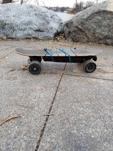

Swapped the one usable hub to a penny board with 10s2p for now. So much lighter than a dual hub with 10s4p on a longboard. Ill be using this until I can fix the broken hub.
