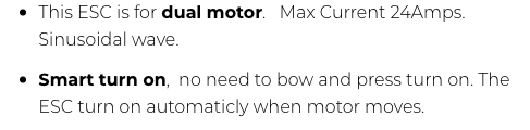

I ordered a new ESC from the meepo guys. The original board is not a meepo but the ESC looked pretty much identical.

Looks like you have to move the motors to turn the esc on ?

Not sure about the roll so turn on thing. Surely thats just an option, Ill give it a go. Thanks for the help.
The spin to power on thing works. Kinda cool. but still no dice with getting the motors to spin.
