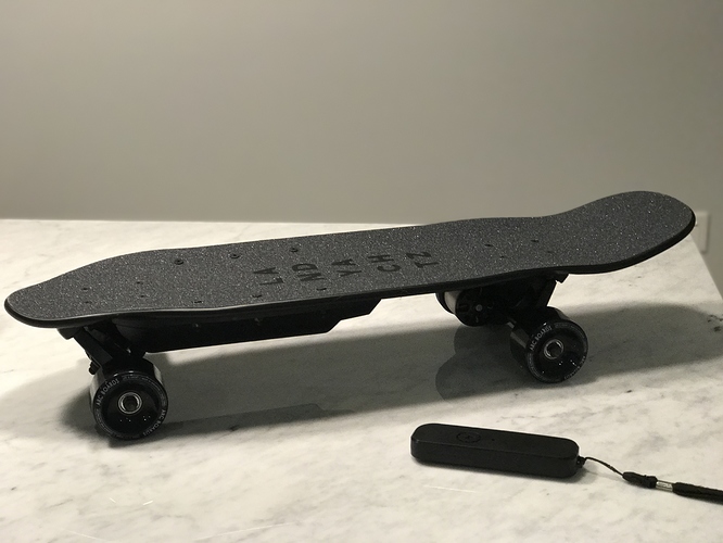

Here’s mine

cause they’re reversed trucks and the 83s are huge on it, very wonky. the wheels are closer together than they would be with skate trucks so whenever you get your foot near the nose/tail the thing wants to pop. I’ve gotten used to it. When my friend got on and put his foot down the nose dived into the asphalt before he got his other foot off the ground. basically the wheel pivot/pop point is closer to the center of the board.
with the ceramic bearings I got in there I can go like 3-4 blocks without touching the ground, seismics ride real smooth, with a vesc hopefully I’ll never touch the ground. shes stupid smooth with a ton of control.
I got half inch risers for motor clearance.

Model is the Dinghy 28’
http://landyachtz.com/boards/mini-cruisers/dinghy-emboss
And it seems he took the guts off of one of the Arc Boards models and put it on the Dinghy. Take a look at @marvinisarobot’s photo…specifically the wheels. And here’s a link to the two models that Arc Boards has:
