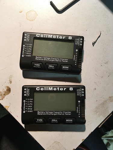

Hi, quick question on monitor voltage for batteries wired in parallel (apologies if this has already answered); but do I need a separate cellmeter for each pack, or can I wire all the balance plugs into one like this:
Pretty much the same question for batteries wired in series: can I just use a cellmeter on one pack and call it good, or do I have to monitor each pack separately, or use a harness like the picture above?

Mainly just want to make sure it picks up the lowest cell voltage out of all the packs (just incase I have one that’s dropping faster than the rest for some reason).
You can have a single meter for an 8s pack of however many parallel you want. Parallel cells balance between themselves and the meter will show the voltage of the parallel set
