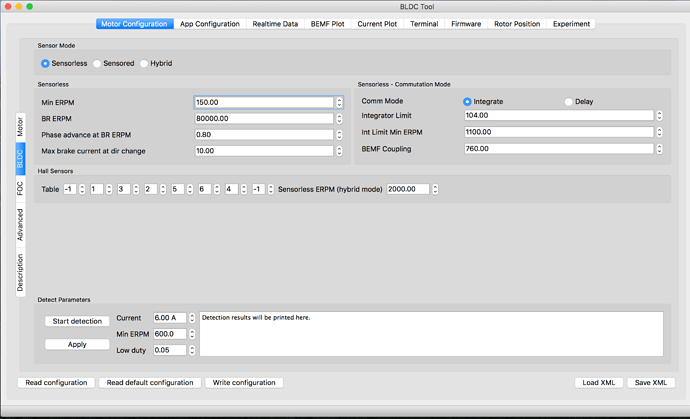

So I’ve read a couple of post similar to mine with some pretty convincing solutions which i have tried on my board but with no use. My problem is that the motor jitters and shakes on low throttle and on full ( i can stop the motor from spinning with my hand). on full the motor can barely pull the board let alone if i stand on it. i left a couple of screenshots of my configuration. I’ve already tried to change start up boost in the advanced tab in motor configuration (changed the value from 0.01-0.1, i was told to not go over 0.1). any ideas?
My setup is: -10S4P 18650 battery -Turnigy SK3 6374 motor -Enertion VESC-X -Enertion Nano-X remoteDoes disabling traction control resolve the low end side ? Did you do motor detection ? (sorry to ask.)
I’ve done a motor detection yes, and i have entered the values for the IL & BEMF coupling. if your referring to the traction control in the ADC tab in app configuration, it’s off initially.

The values where also initially close to yours then I changed it in hopes it would work, besides I think the cut off you suggested is too low.

Do a new motor detection. If it works, hit Apply and then Write Configuration. Reboot your Vesc and see if something changed. If your detection fails, you have to investigate further on your motor.

i returned the values and did a detection test, but still no use. the detection was successful by the way
