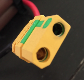

However, once I plugged the xt90 to the Vedder Spark Switch(I soldered myself), there was a light emitting out of the green portion of the female plug and it sparked(ironic right?) and smoked, but only the male connector was badly damaged for some reason. I am now scared to plug the XT90 in again. I haven’t tried to directly plug into the VESC but I have check to voltage to be 46.8v which is lower than a fully charged 12s lipo pack I tested earlier.You may want to recheck every battery for a burnt connection/solder joint. One of those batteries may have a sign of puffiness. All wired connections must be spot on down to the xt90. I use shrink tube around the xt pos/neg posts. I prefer ec3 or ec5 depending on the amps/voltage. Good luck
Thanks but I figured out that the problem was the XT-90 anti-spark connector. Just an advice to everyone else, don’t use 12s or higher voltage on anti-spark connectors, you will damage both female and male plugs.
