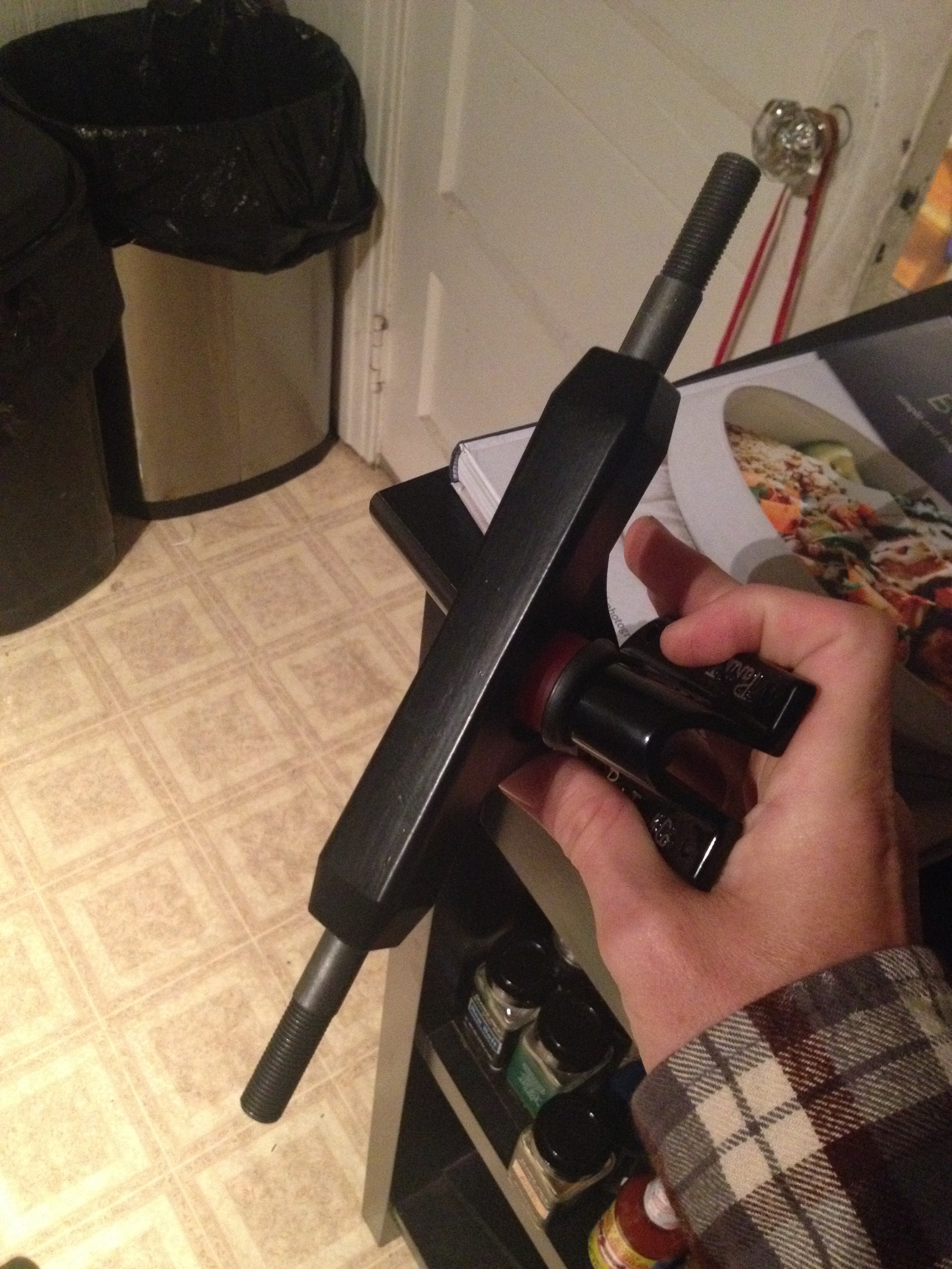

Those trucks are massive. Mind me asking how heavy one of them is?

jesus, what happened to that scale!
Glad to hear ur interest. It always takes longer. I’ve been telling people 2 weeks for months but parts are now here. 2 more weeks till they’re done! Thanks those of u who are waiting patiently. @Vampiresquid64 it’s got lots of rubber on it from pouring pu wheels in the past and other stuff. Too scared I’ll break it if I try to remove it
