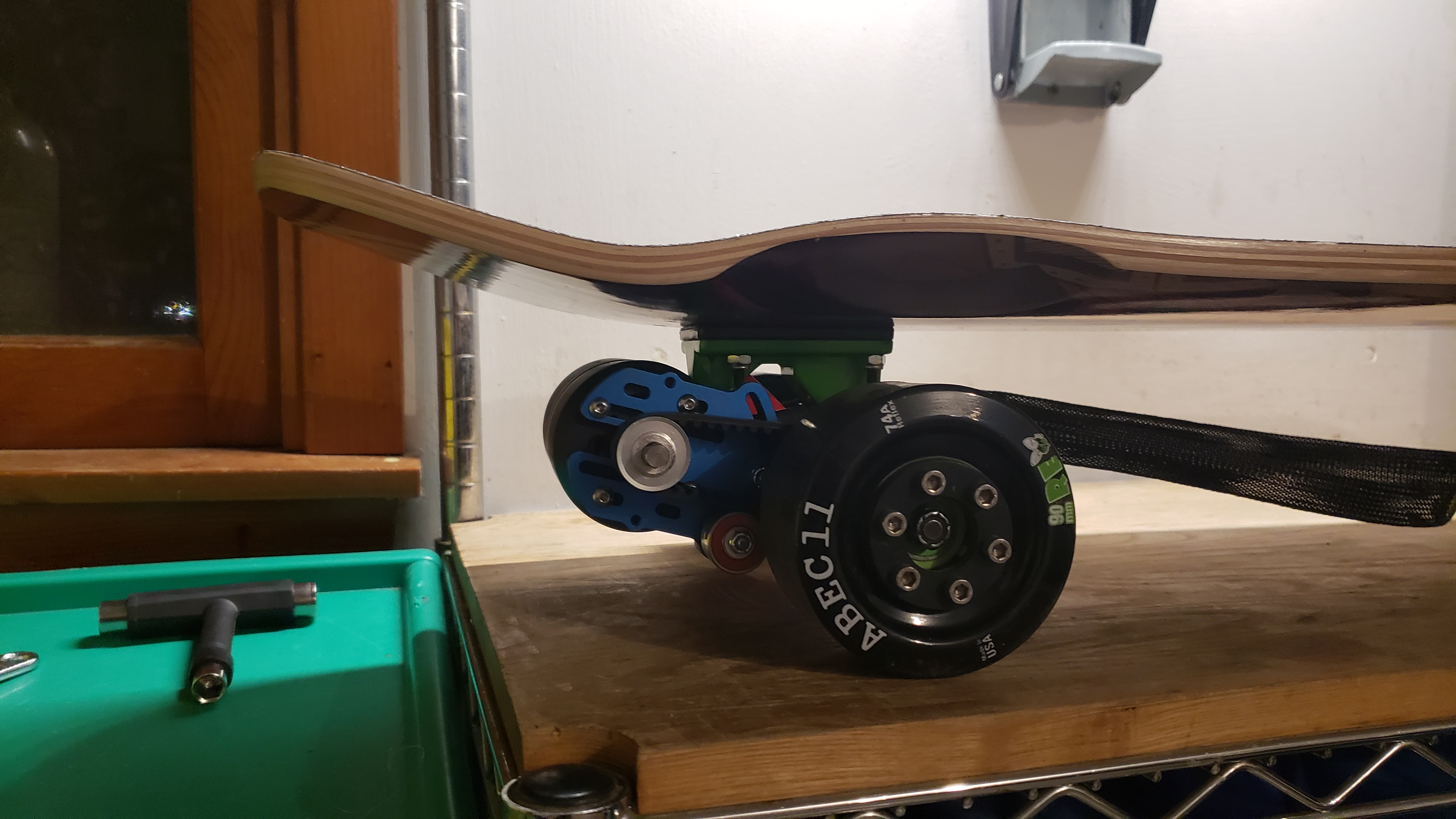

I am calling it Cinco because it is my fifth board.
This is my third build, and the first one I am posting.
I wanted something that looked more like a regular board.
But still need speed and range, which meant large battery and large enclosure…
I like the look of the Muirdered Deck, it is massive at 37x10". Real nice concave and wheel wells.
I need to get some Jessup Grip Tape on there, as I do not like the rough ass grip tape that came on the board.
Huge thanks to @Psychotiller for his awesome battery packs and enclosures.
I flashed Ackmaniac on the Maytech Vescs.
Running BLDC at 65 motor max - 30 battery max.
Running Sensored.
Haven’t gotten to ride yet, because of stupid wet winter in Missouri. Hoping tomorrow will be my day.
I am not able to get data on the Ackmaniac app off of the flipsky Bluetooth module.
The module shows up. but there is no Data…

Had to go out. Dry roads. 22f(-6c). That is butt ass cold… So it was a brief ride in the neighborhood. Board is fast fast fast. I may have to go to 34teeth wheel pulley… The 90 mm abecs felt really smooth. I also really liked the concave.
Thanks. 60 cells. 10S6P. If you mean dimension wise, I did not get an exact measurement. it is 2 rows of 18 on the bottom, and 2 rows of 12 and the BMS on top.
