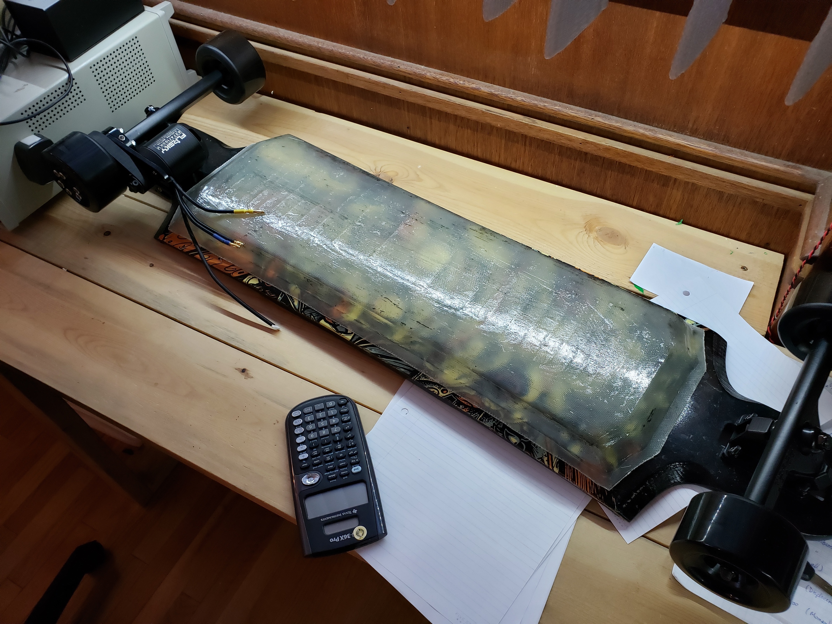

Hi guys,
first attempt at vacuum bagging an enclosure.
Question:
The surface of the enclosure is opaque in some areas and lucid in others as if while removing the peel ply tape (didn’t checked it) some epoxy remained on the tape.
Why so? Is it normal or is it bad? Bad curing of the 2 component epoxy?

It is Lucid in some areas because those areas didnt get vaccumed down making contact with the peel ply. Most peel plys leave some texture to the finish as they are porous allowing extra resin to seep through to get soaked up by the breather bleeder.

Well typically you get a glossy finish on the surface between the mold and the part. So in your case, that should be the inside of your enclosure.

The mold is very shiny and the finished product will reflect this finish. The vacuum ply will leave the part dull.
Hi @Sender. That’s exactly what I suspected. So I wet sanded the porous surface just a bit and then applied a final layer of this two component epoxy resin, which I also used to sandwich the 2 layers Glass fiber + 2 layers Carbon fiber before.

I think wet sanding was a good idea because it helped me understand when to stop sanding:
basically when you pour some liquid on the sanded CF fiber you have sort of a preview of the epoxied surface.
