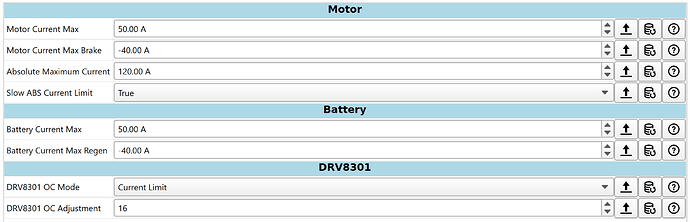

I’ve got a 12S dual VESC setup with hummie’s original steel hubs, with retrofitted hall sensors. With FOC, startup is very smooth with moderate acceleration (much more than my single belt drive could do) but if I slam the throttle wide open, the motor starts up, then stalls and stutters. I’ve tried adjusting the speed that the hall sensors disengage at, and found that this stuttering has happened regardless of whether or not the sensors are being used. The problem doesn’t occur with BLDC mode, so I’m hoping that my detected FOC motor parameters are just off. Or maybe it’s something else, please comment if you have any suggestions because I’m at a loss. Also, the motors are running very hot- I hit the temp limit of 70 degrees C after just a mile or so of hard riding. What are the settings other people on similar setups are using? Mine are:

Yeah, just in FOC>General>Sensor Mode and in General>General>Sensor Port Mode, right? Also as an aside, I put the motor max current down to 30A and the issue is still there when I floor it. Maybe I am expecting too much of the sensors? I just expected them to be more robust than this.
Perhaps there is a control loop somewhere that becomes unstable with too sudden of an input? I’m in current control mode with the Nunchuk app, so I’ll look at maybe reducing Current KP in FOC

Alright, looks like I made an incorrect observation earlier. I put “Sensorless ERPM” up to 7000 (corresponding to ~15km/h) and I can floor it with no problems. My only concern is the potential inefficiency when I’m just cruising along on a low throttle setting with those sensors. Under no load, I’m reading double the current when running using sensors vs sensorless.
