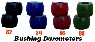

The EXskate Torsion bushing look to go down to 82 for their lowest medium hardness in the black. Can’t find any one with any stock of these though.
