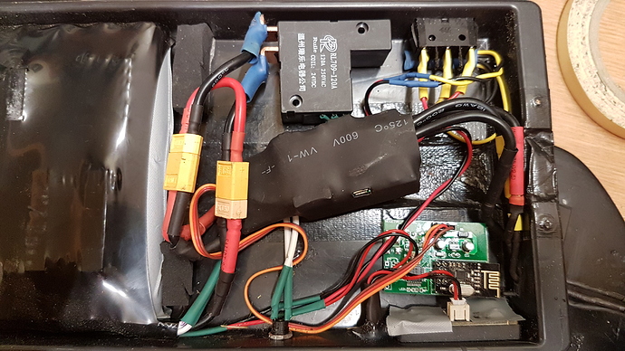

You could try something like my switch?
It’s a 120A momentary latching relay switch driven by 24v
Move rocker switch one way (momentary), it latches on, current can flow, move out the other way (momentary), it switches off, no spark. This type (rather than MOSFET type, doesn’t consume power the whole time it’s on.
