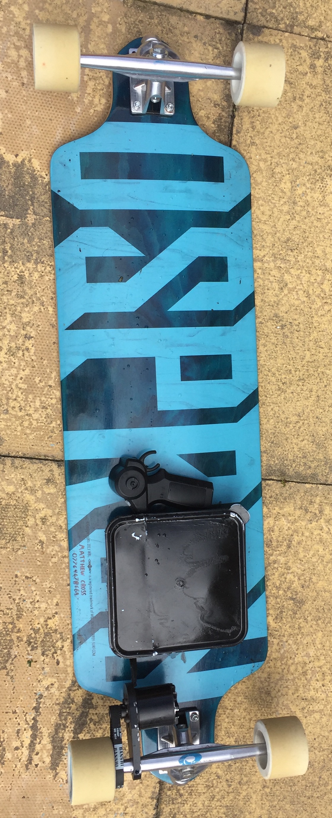

My goal was to build a board for as little money as possible but still would be a decent board.
Specs:
Top speed: 15mph
Range: 9km
Parts list:
After discounts and postage this all added up to £210
Here is the result
This looks pretty good, and pretty damn amazing at that price!
How does it ride? Any issues?

It rides great. Good acceleration gradient so it doesn’t knock you off, good breaking so can handle steep hills going down but I haven’t tested going up a steep hill yet, only a small hill which it handled fine.
Only issues have been fitting the gear to the wheel which was difficult and had problems with vibrating out screws which was quickly solved with Loctite.
