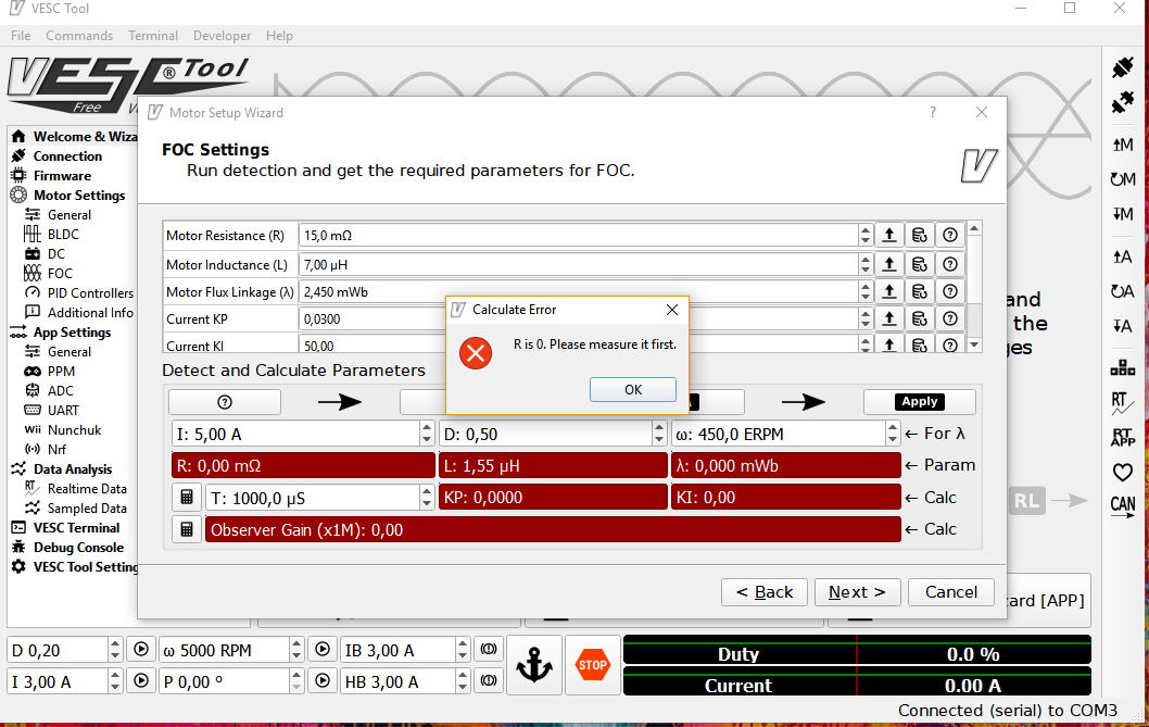

hey there, I just received my new flipsky dual vesc V4, but I keep running in the same problem. When in the VESC tool I’m running the motor wizard setup of the master I have a bad detection problem. I’ve tried to switch in FOC, and when I run the detection and measurement of resistace and inductance the motor isn’t spinning at all and there are just a few noises and a message after a while is shown I’m running a 10s5p and two 1600 Watt motors edit, I forgot to include, when I use the remote and I accelerate there is no spinning at all, just a small noise kinda the motor tries to power up and then the red light from the master start blinking, but the slave even in the motor setup can work fine

ok, just did, I copy the text it’s giving me cos I can’t upload the screenshot
The following faults were registered since start:
Fault : FAULT_CODE_DRV Current : -5.5 Current filtered : -18.9 Voltage : 37.86 Duty : 0.440 RPM : 90.4 Tacho : 1 Cycles running : 7 TIM duty : 3697 TIM val samp : 2 TIM current samp : 4200 TIM top : 8400 Comm step : 5 Temperature : 31.26
Fault : FAULT_CODE_ABS_OVER_CURRENT Current : 151.1 Current filtered : 144.0 Voltage : 38.62 Duty : 0.001 RPM : 40173.9 Tacho : 2 Cycles running : 0 TIM duty : 2 TIM val samp : 1050 TIM current samp : 3150 TIM top : 4200 Comm step : 6 Temperature : 30.97
