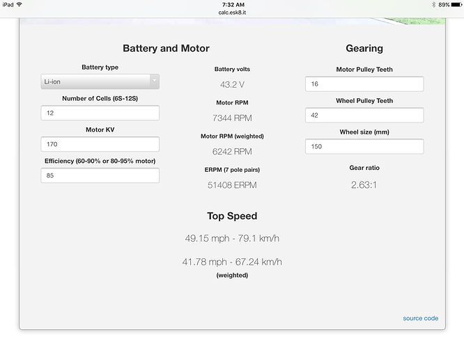

I don’t think the vesc can handle more than 12s. For your speed requirements though I did a quick calc on the esk8 calc using a 170kv motor on 12s. This is using psychotillers 6" pneumatics and his 42t wheel pulley. It’s crazy!!
Sorry I didn’t really answer the question. You can buy quality motors from any of these people. The 14s thing isn’t really going to work as far as I know unless you want to exceed motor and vesc limits and make magic smoke.
