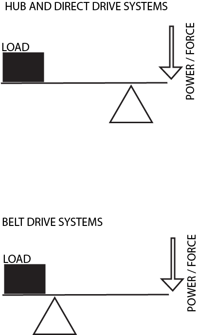

I think the point is that focusing only on loss of energy during transmission while ignoring mechanical advantage is not a really robust way of looking at this. It’s like saying a unicycle is superior to a bike (assuming the same wheel size) for achieving high speeds because there’s too much energy loss in a chain gear reduction and a unicycle has no loss because it is direct drive. This argument ignores that your legs pedal at an optimum rpm and that rpm is much slower than the rpm needed to achieve higher speeds in a bike wheel.
I updated your graphic to make it more accurate.

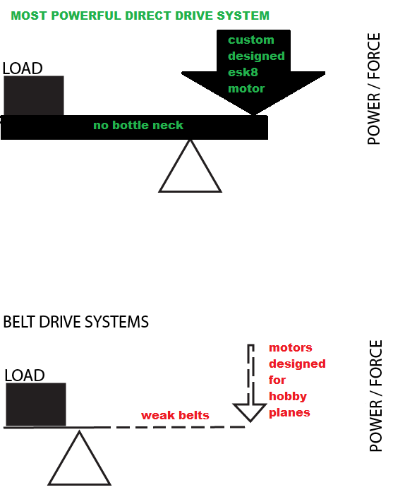

HERE IS ANOTHER GRAPHIC TO HELP YOU ALL UNDERSTAND.

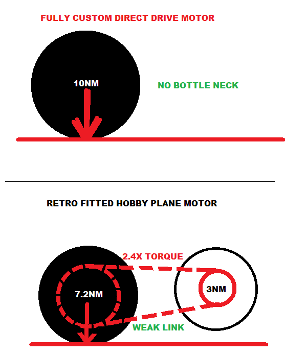

If the belt guys want to compete on performance they can increase the motor torque output (design better motors), but then you reach a torque transfer limit of the belt. the belt is the weak link if you want maximum power at the wheels.
onloop are you drunk ?
At what speed do you achieve 10Nm?

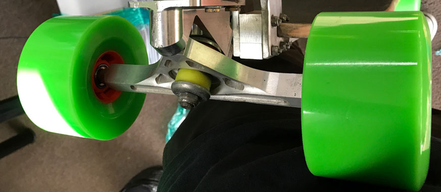

I think it’s great to see a number of different approaches at getting people on board electric vehicles. Most of my early contributions will be of the “mechanical” types … wheels, pulleys, trucks, steering and damper systems (more on that later), motor mounts, collars, decks, bearings, and bushings. Although personally reluctant to go the hub-motor route, I’m happy that others are. There isn’t ONE way. And on the the chance that you want to try some bigger wheels with even more urethane and a wider contact patch, pray that I love these 107mm SuperFly’s in 74a Reflex Formula urethane and that a big rich esk8 company can help keep Abec 11 alive because these are just way too f’ing nice to keep to myself …
If your pulley fits any Classic Flywheel, it will fit these new offset 107mm SuperFly’s … Summer 2017, 83mm, 90mm, and 97mm SuperFly’s to follow …
