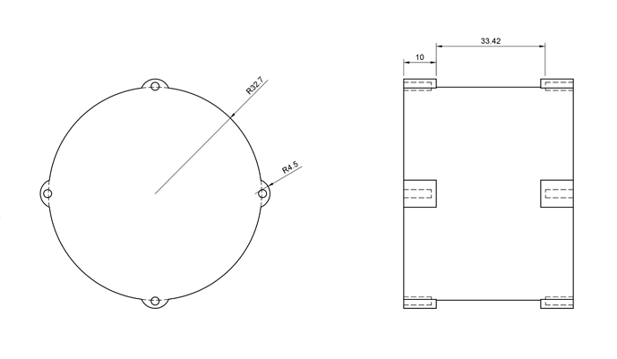

make sure you get the nylon centre tubing. the wheels are actually a little bit bigger then they need to be so adding so thickness will help and if you get a matt shrink tube it might have good friction with the wheel. my only concern is the the shrink tube will not keep its shape through the centre of the grooves so you will still need to put some thing in there. the design that i sent the factory actually never had the gap and i donât now why they didnât but it you could drill out the thread in the groove and extend it to do the whole way through, then when you 3d print the spacers you can add a hole in them and actually stew them in place so there is no need for glue.
Id get the heatshrink that comes with glue, theyâre extremly durable!
please can you draw this, I donât understand it.
Here is the drawing you posted: The threads are too deep in diameter to extend them, the material of the stator would be too thin then or did I get it wrong. Btw. the bumps havnât R = 4.5 itâs about 2.5mm.
