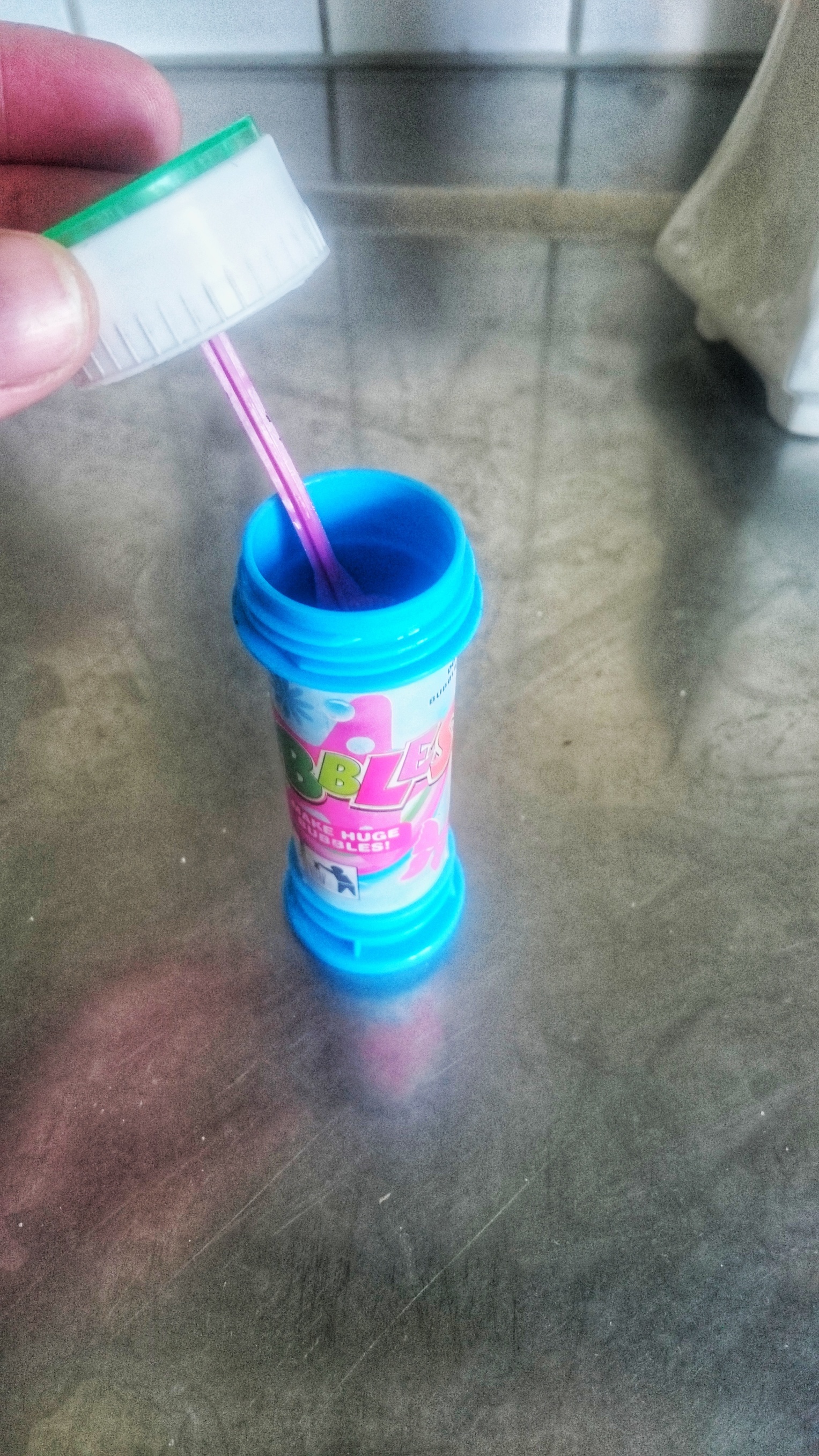

First off is this stupid little thing that we have far too many of lying around the apartment. Kids love bubbles. Me not so mucho.
So I use this whenever I clean bearings. Pull out that middle thingie and put the bearings on and push it back onto the lid. Fill it up with isopropyl alcohol and shake. No need to buy "expensive " bearings cleaners! Yaaay.
