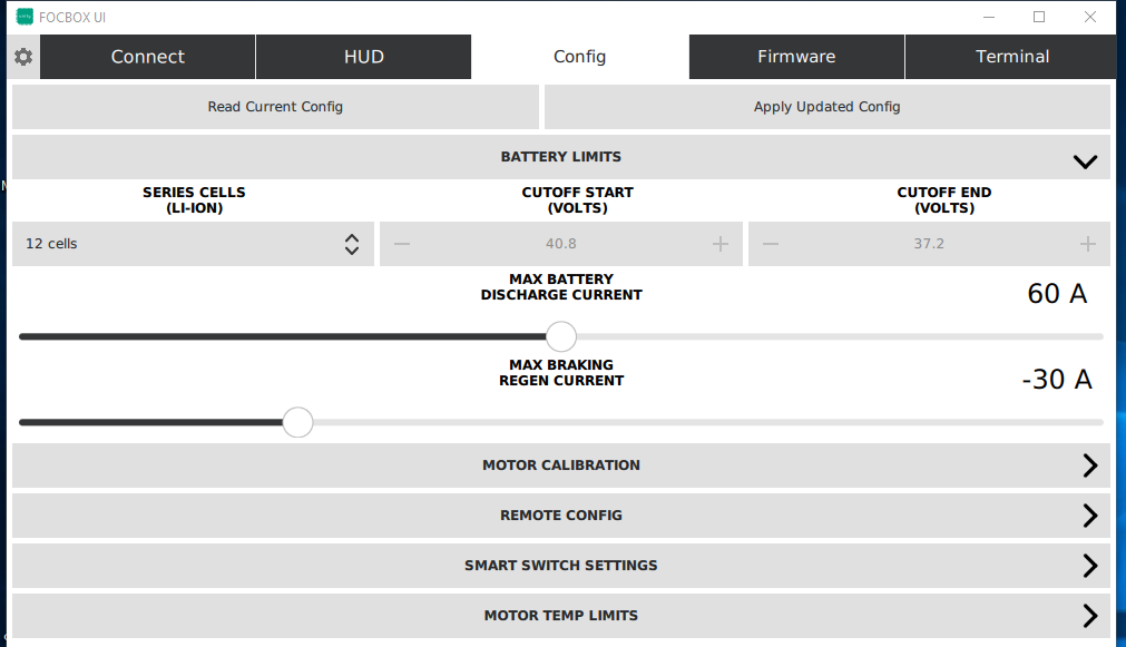

I am having trouble “taming” my new build with 12S4P and 6369 200kv motors. The board has a tendency to throw you off the back if you accelerate too quickly. Maybe I shouldn’t have named it “Hellboy.”
I have fooled around with throttle curves, but also read the post from @trampa carefully when he discusses PPM and Motor / Battery Max / Regen. Currently I am at the default FOCBOX Unity settings of 60 and 30 amps,
Is there a different setting I should try? I need a better understand of what the current settings do and what baseline / best practices are helpful setting up Unity for a custom board.

lower your current settings. ex: try motor max 50 min -50, batt max 40 min -20

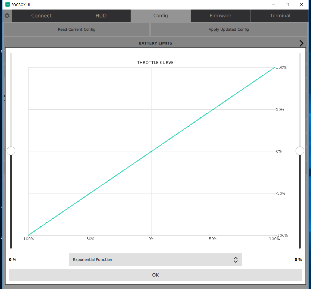

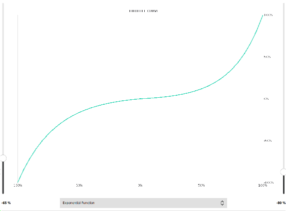

play with the throttle curve, smooth out the lower portion of the ppm curve with the exponential curve
example: image

@blasto I will try option 1 fur sure. I wish I had detailed explanations on what those terms mean exactly. For example, where is / what is the PPM section?
On the throttle curve, the suggested curve above seems to push the acceleration problem into faster speeds. Instead of an explosion at 5 miles per hour, now I get one at 20. I think this is what Frank meant by saying the power curve was of limited usefulness.
Keep in mind the throttle curves input is amount of throttle not speed. But yeah I like to keep mine at -10 %, -10%.

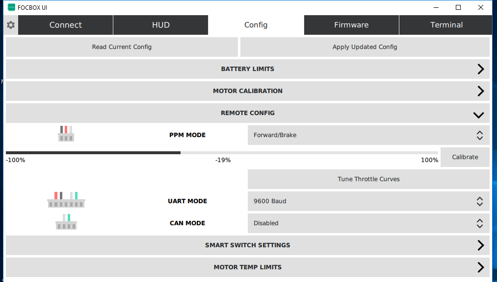

You ran the remote config→calibration in the setup to get min and Max for your remote when it was in the fastest mode? This might be your problem I have tested a hoyt remote here and the timing of it was a bit strange. I’ll be adding some more notes/steps to guided setup with the next release to explain more things quickly without walls of long text.
If you ran min/max calibration in a slow mode with the remote it could definitely mess up your sensitivity.

Hera are my current settings. Also the motor has 6 wires, this one here: https://psychotiller.com/product/sensored-6365-200kv-motor

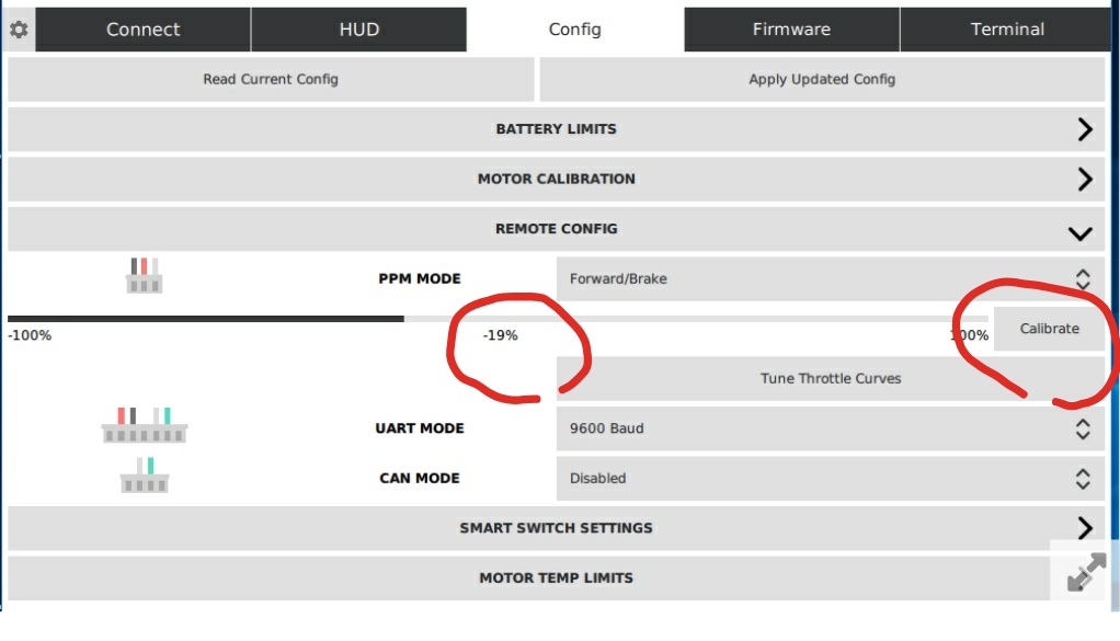

Are you touching your remote here? It’s reading out -19% for some reason which is strange. I’d re-run the calibrate routine making sure it’s in the highest speed mode. A screenshot of that submenu would be helpful too if you are still having issues.
Yep. Talking to Hoyt about that. They are wondering if it is old firmware.
One of those four buttons on it is a little Trim pot I think. Could try twisting that maybe? Probably shouldn’t mess with their debugging process I guess :smile:.

Ah yes there’s a trim on the hoyts remote, it’s the bottom right button, it’s a little rocker switch.
@billappleton try to trim up the signal by pressing the trim button up, you want to get the idle position to 0%
Do it while connected to the tool, you will see the graph move
Hi @Blasto, I had the same thought, but the Trim button on the remote does NOT change the -19% number, going up or down either way.
Response from Hoyt: "I’m not familiar with the FOCBOX Unity user interface so I’m uncertain if it’ll work the same way as a Vesc Tool. The following process is how to set up the Hoyt RC with Vesc Tool. Not sure if this sheds light on what may be happening in your situation.
The Vesc Tool has a set up wizard for the remote control. Set the RC on Mode 2 and then go through the set up wizard. Don’t need to adjust or tweak anything. Modes 1-3 were calibrated in the RC firmware based on VESC default settings so no further calibration is required.
There will be (should be) no braking when the throttle is not engaged."
Should I calibrate on Mode 2 for Unity? Is the trim working / not working?
