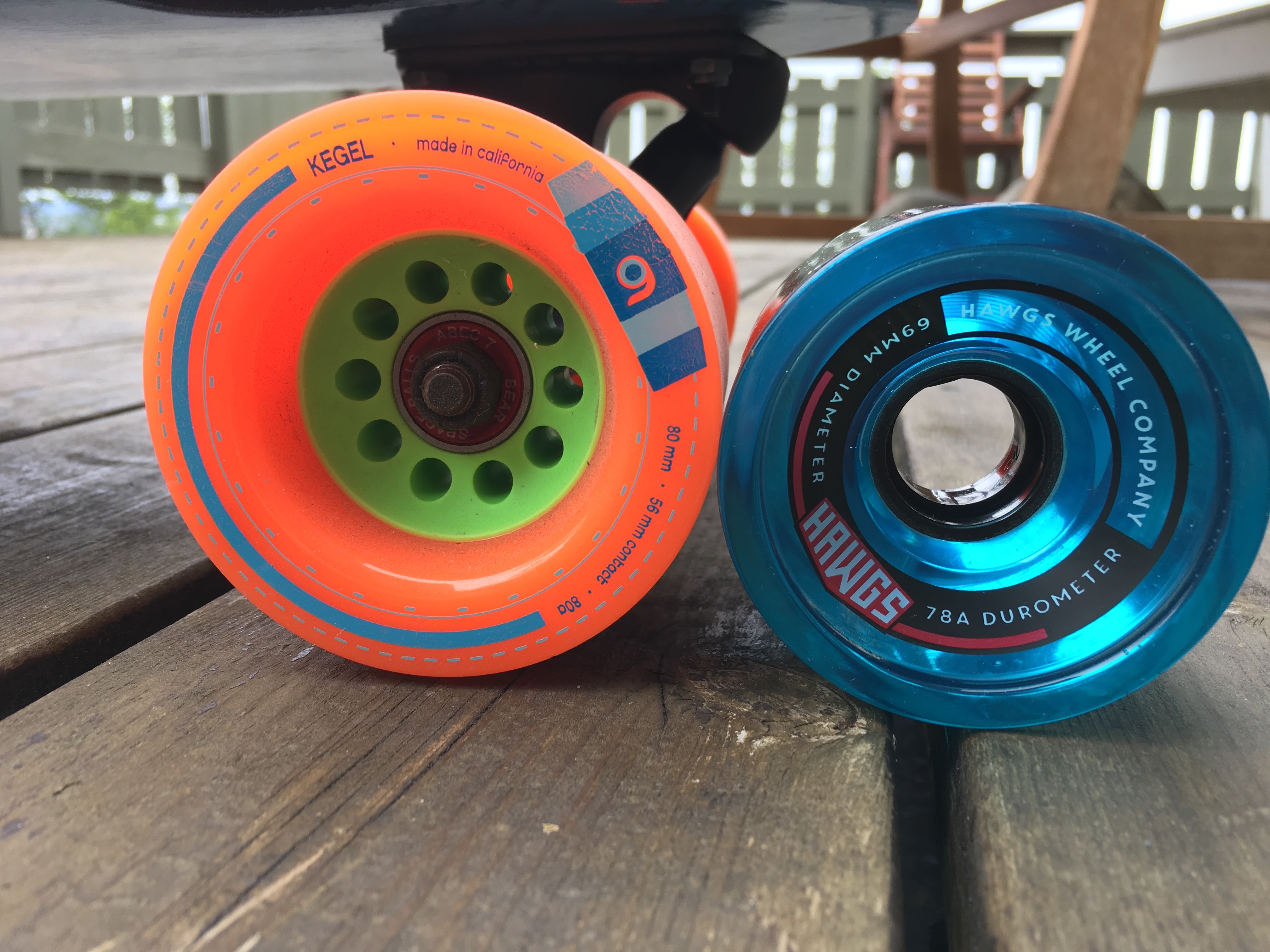

After a testrun, my conclusion is that the difference between 78A and 80A Is actually noticeable, or it could be the design difference of the wheels that makes the Hawgs a bit softer and more comfortable, even though they have the smaller diameter. Also I think this board benefits from the lower ride height the Hawgs gives. Anyways, the Kegels are very comfy as well and allows for a plug and play solution with the DIY kit. Should be no problem with clearance for the components underneath now, and they look really good, all bright and orange

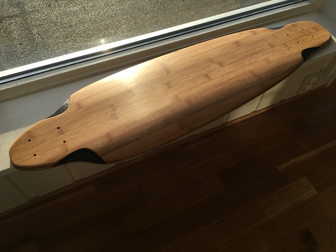

While waiting for parts to arrive, and with the nose cut, I thought I would paint it black to protect the exposed wood (grass actually). But I realized the board would look much better in its bare bamboo. Since I had the time to do so, I sanded it down gently and gave it some coats with oil.
