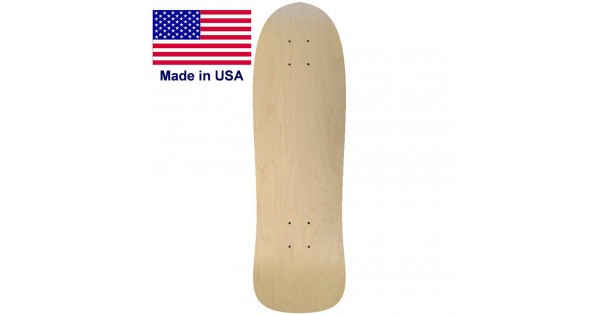

Deck I wanted a board around 30" to keep it light and easier to carry up stairs. I ended up with the Slide Pool deck from CustomSkateBoards. It was cheap, not painted funky, and short but wide. Got the grippe from them too because it was $5.
