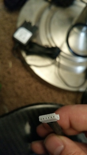

You need this header to fit the VESC.
OK so i managed to avoid the constant spikes that occur in the input by making these adjustments to the throttle curve… its works!! now i can gun it and not get spikes. .sure there will be latency but maybe i just keep playing with it and im planning on dual motor anyways…
damn ya i dont have those jst connectors… i should get em cuz their worth it right?
