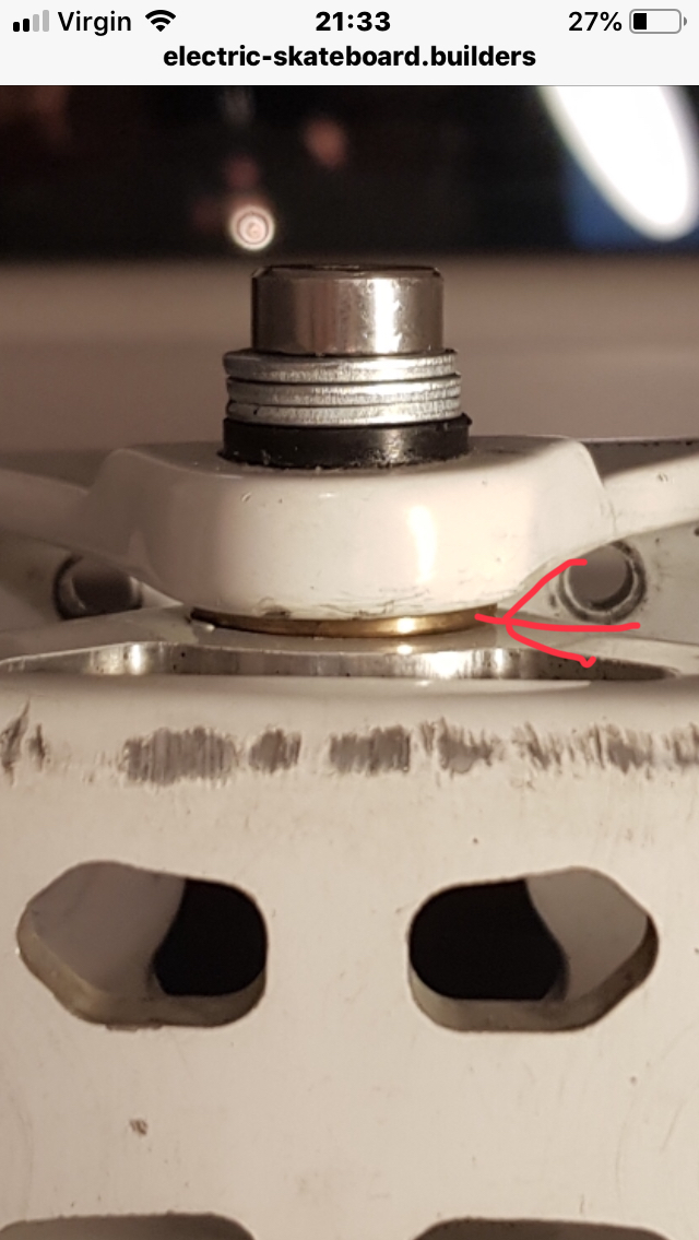

Hard to See but on ride it turn left pretty hard (pics after bending kingpin to tolerable straightness)

Shame to hear about the board pal, doesn’t look to bad. Take the hanger off and check that (it’s prob fine), kingpins will prob be fine too. Looks like the baseplate may be bent though. What is the bushing it the middle ? Looks different ?
Bushing is my made from beryllium bronze, not bended. And dude kingpin before I bended it back look really bad. I love my board and my heart is broken. In about few days aluminium rims will come and I cannot put it on ;(
Could just be the pic but that left side axle (right in picture) looks bent to me. Does it wobble really bad?
Pretty sure that’s a titanium kingpin. Wow! If that’s bent.
Has the metal bushing you’ve added made an imprint into the aluminium? If it has that won’t help either.
But yeah, don’t think the kit is to blame here. Get in touch with Trampa. I’m sure they will help you out with replacements.

venom121212 you are right, I did not see it, it is getting worse every second. No wobble at all.
No marks at all from bushings, or Trampa makes from poor material or my board is really powerful… I don’t know.
