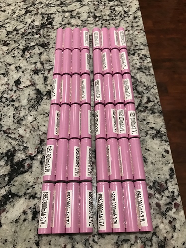

Well the time has come! I want to first thank you all for helping me get everything together to make sure I have the best parts for this setup. Here is where I’m at currently.
-15ply Trampa Deck.
-Trampa trucks. Vertigo front and Infinity rear (rear no cutouts due to cracking issues with these
wheels)
-Torque VESC x2
-12s4p 30Q cells
-Dual 6374 190kv BKB Motors
-Kaly Motor Mounts
-Kaly Battery Enclosure
-16/40t gears
-100mm MBS All Terrain Wheels
-Vedder Anti-spark / On off switch
-60A BMS
-Metr Bluetooth Module
My goals were to have basically as much torque possible with still being able to achieve 30+mph. With these motors and this gearing I’m pretty confident I’ll be there.

is the battery enclosure supposed to be centered perfectly on the deck? I didn’t realize that the batt box isn’t completely symmetrical front to back so for the two center joint to be right in the middle of the board the box won’t be perfectly centered.
for serial connections I was thinking about doing either 14awg or 10awg. I saw somewhere that you want them close to the center of the pack to make sure the parallel doesn’t see full current (become part of series circuit). So would you suggest 2 in the middle like this?
