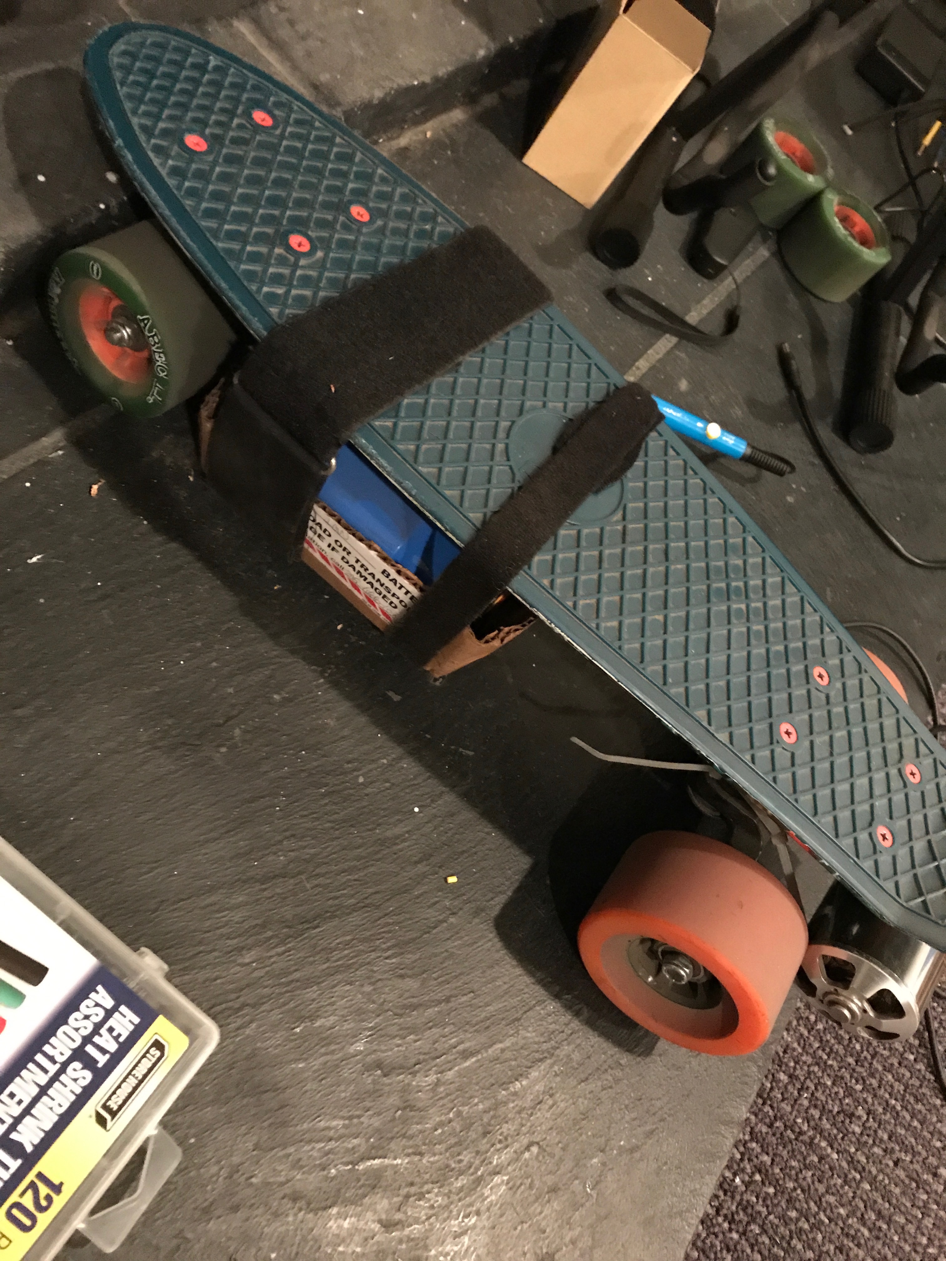

Almost all of the parts finally came in. I soldered on larger bullet connectors to the phase wires of the ESC to fit the ones I already had on my motor.
I took a short ride on it and so far it’s exceeded my expectations. Obviously it’s way slower than a dual drive or even most singles, but the start-up is smooth and the motor runs quiet. As far as I can tell, the battery is performing fine as well, seems to have no trouble delivering max amps the ESC calls for (which is about 30A burst).
For a first board or even a cruiser board, this battery-ESC combo seems to be a good budget option considering it comes in at under $80 for both and once you have them, all you need is a motor, a mount for it and some gearing.
I currently have it all strapped under the board in a cardboard box. Obviously I won’t be riding it like this, this is just for testing purposes.

Update: So far this board has Far Exceeded My Expectations given that I only put $100 into it. It accelerates as fast as I’d want it to, with power to spare. (Keep in mind this is on a penny board so the maximum acceleration I could withstand before being through off the board is much less than on a longboard). Never the less I very impressed with the board. The pulley kit finally arrived and it’s worked great so far. For $15 and a month of waiting, it’s a great deal.
I think this would make a great first board, and I’m planning to keep it and use it for when I just want to take a smaller board.
The one problem I have is the shape of the battery. It is about 2.5" tall so it practically touches the ground when it’s mounted underneath the board. I’ve come up with 2 solutions. Either mount it on top of the board like a lot of guys do with their Trampa builds, or disassemble it and remake it into a smaller pack using the cells. I think @GrecoMan has do that with this battery. How difficult and time consuming is it?
