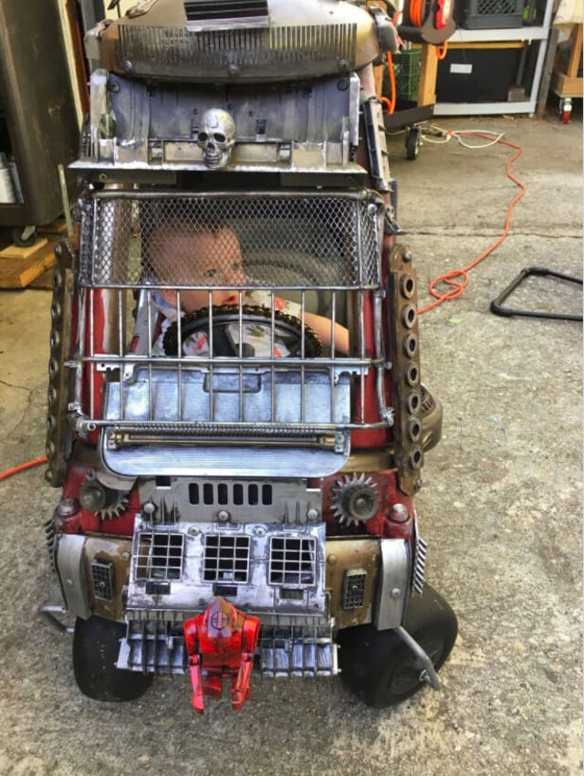

I always was joking about turning one of those little tykes AMG Mercedes into a wicked e-vehicle…
This
To this
To be more clear I meant these types, I just picked that one because it had a good before and after to exemplify my point
