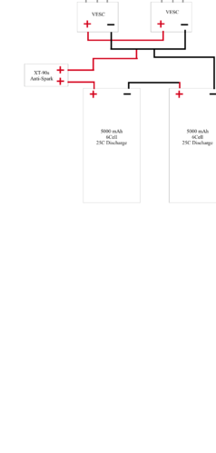

It’s probably better to put the loop key on the negative line but electrically it makes no difference. BMSs switch the negative lines and positives get tied together
It can just be less confusing is all. Electrically it makes no difference
Thank you. I was mistaken when I was drawing, I meant what you did))
