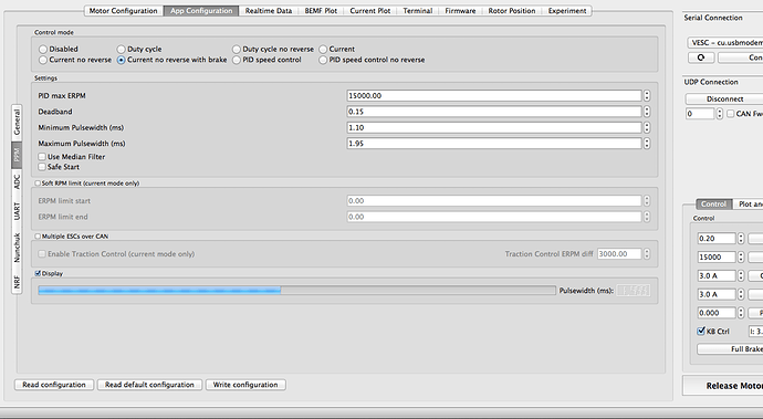

My Maximum Pulsewidth (ms) is set to 1.95 and the Minimum Pulsewidth is set to 1.10. The motor still starts at max speed. Here’s a video to demonstrate it.

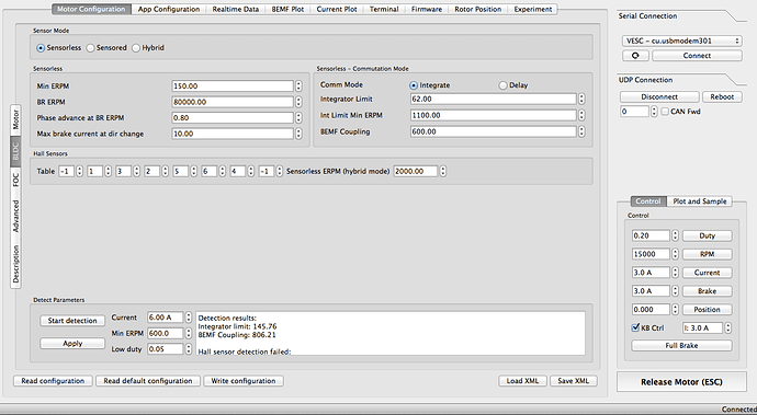

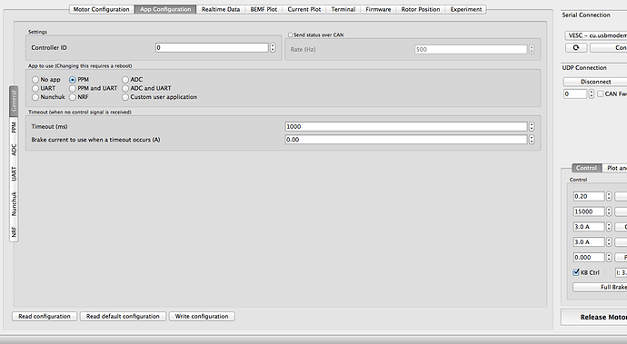

Here are my VESC settings:
Motor values
BLDC values
General values
PPM values
My battery is ACTON’s Blink board battery which I believe is 10s1p 42V. The motor is also from this board and I have no idea what are the motor specs. I am using Maytech VESC.

I see where you did the motor detection, but you didn’t apply it & save. Try doing that and see if it helps. Also, you need to have a load on the board when testing, testing on the bench will not show you the actually AMP/Voltage delivery under load so it looks like it spins at 100% when in reality it doesn’t.
Lastly, I would use a multimeter to find out the voltage of the battery for sure before I went any further.
