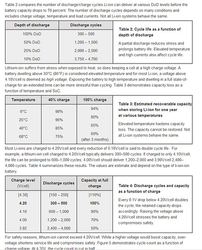

And Smartphone batteries are known to last forever . And Industry tries to make money. Everything that lasts forever doesn’t create money in the industries wallets. And of course not many would buy a battery with charger that has 20% less capacity because they only charge to 4.0V.
@Kug3lis Didn’t you read the stuff you posted yourself? Especially the last table.

@Ackmaniac, a little secret though… Those tables are inflated. A lot. Based on my own research.

Do you have own tables?

Can’t share them shamefully since they are work related.
