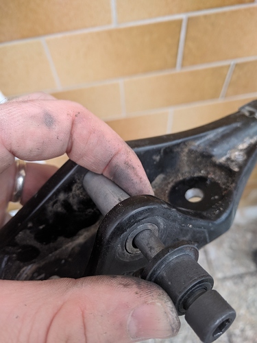

still not done - stock trucks/wheels Whilst working on the board and actually using it, it became obvious where manufacturing corners were cut on moving parts. The trucks are unstable due to a variety of reasons and you will easily encounter speed wobbles beyond 30 km/h offroad or with unpredictable wind.
The reason for this is that: A. These trucks are not precision engineered (no cnc) B. These trucks do not have dampeners
The bushings and kingpin all have several mm of free play. The bushings are actually too small for the trucks (or the holes too large) and just by looking at the picture below you will see what the remaining issues are. Nothing fits. Aligning bolts and bushings is difficult if a truck is not precision engineered, so instead they decided to create oversized holes for pretty much everything. In addition to causing speed wobbles, it creates a hell of a noise.
The next step is to see if new bushings will resolve the issue. Last resort is drilling oversized holes and machining custom bushings to resolve the play. If that does not work, it will be time to invest in a more expensive board as my platform (MBS or Trampa).
