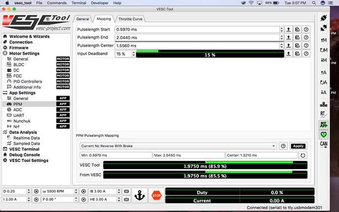

Im using the new tool to set up my focboxes, but when I finish using both wizards the esc won’t spin the motors. I can go into the ppm tab and see that it is getting the signal from the receiver. And when I do the motor detection it spins the motor, but won’t spin from the computer controls or controller. (was setting up in for, but also bldc won’t work either) any ideas? @trampa

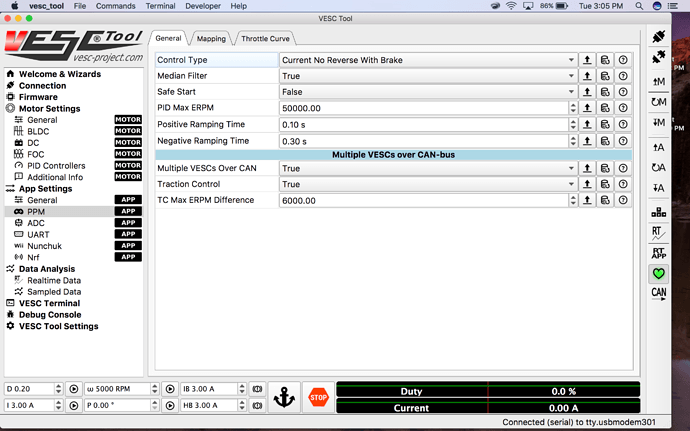

Under App settings -PPM. “Control Type” did you set it to "Current no reverse with brake " And Write to the vesc ?

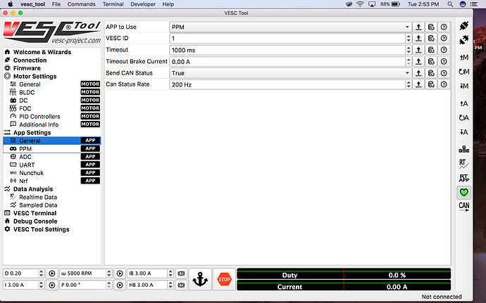

What about App settings -> General -> “App to use” ? Does it say PPM or PPM and UART ?
